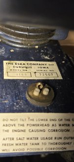

Hi I bought a 5hp eska 2 sroke.motor for my canoe I'm the ponds. Anyone know how to get the chole nob off I need it of to access carb it has a silver ring on it on the end. Here is a photo along with my serial number for reference . Don't want to damage and need in there. Thank you also any direction on what to do to an engine that apparently ran good 2 years ago when last used. I've pulled ut over alot. but haven't got access yet to do anything else really. Doesn't sound like units even trying but compression seems good

Maybe it unscrews? The choke knob has a lock washer between the plastic knob and the brass shaft.
Lol. It actually does unscrew was just being to gentle with the old giant 🤣
