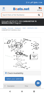

Timing does not normally go out of adjustment.-----But check for a sheared flywheel key !----And check for a cylinder sleeve rotated out of position.----You did remove high speed jet ( orifice plug ) from carburetor bowl to clean it ?----Nozzle gaskets in place in carburetors ?

Nozzle gasket? Is that the flat gasket that goes between the pickup and the carb body that's in the center of the float? Number 18 in the parts diagram, yes they were in place.

I figured it out, the middle carb wasn't getting enough fuel. I forgot to install the center gasket in the carburetor bowl, emulsion tube gasket?
