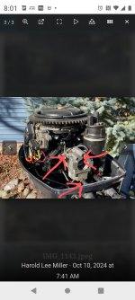

I have to buy a socket extension to get the starter off (that bottom bolt) and then remove the carb for cleaning... Here are photos of the motor.
