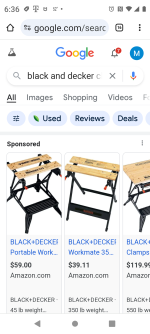

Any miracle goo in a tube but best to use marine grade.
I find these work well to hold the gearcase if needed.

I use a plain old vice with two pieces of wood to clamp the skeg. Not as good as a workmate.
