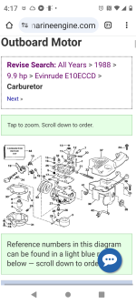

Working on a 1988 evinrude 9.9. Plastic top carb. Original top was cracked. I installed one that looks just like the updated kit which uses a plastic nipple in which to slide the throttle roller onto. I transferred the needle valve from old to new (this version uses a front mounted mixture knob). There was a threaded hole on the opposite side from the roller on the top carb cover. I threaded in a screw with an o ring and tested it for leaks with compressed air into the hole on the underside of the cover. When I run it seems rich very smoky. I was able to turn the mixture knob all the way in and it stayed running. Not sure where to go from here. Looking for some suggestions please. Thanks
