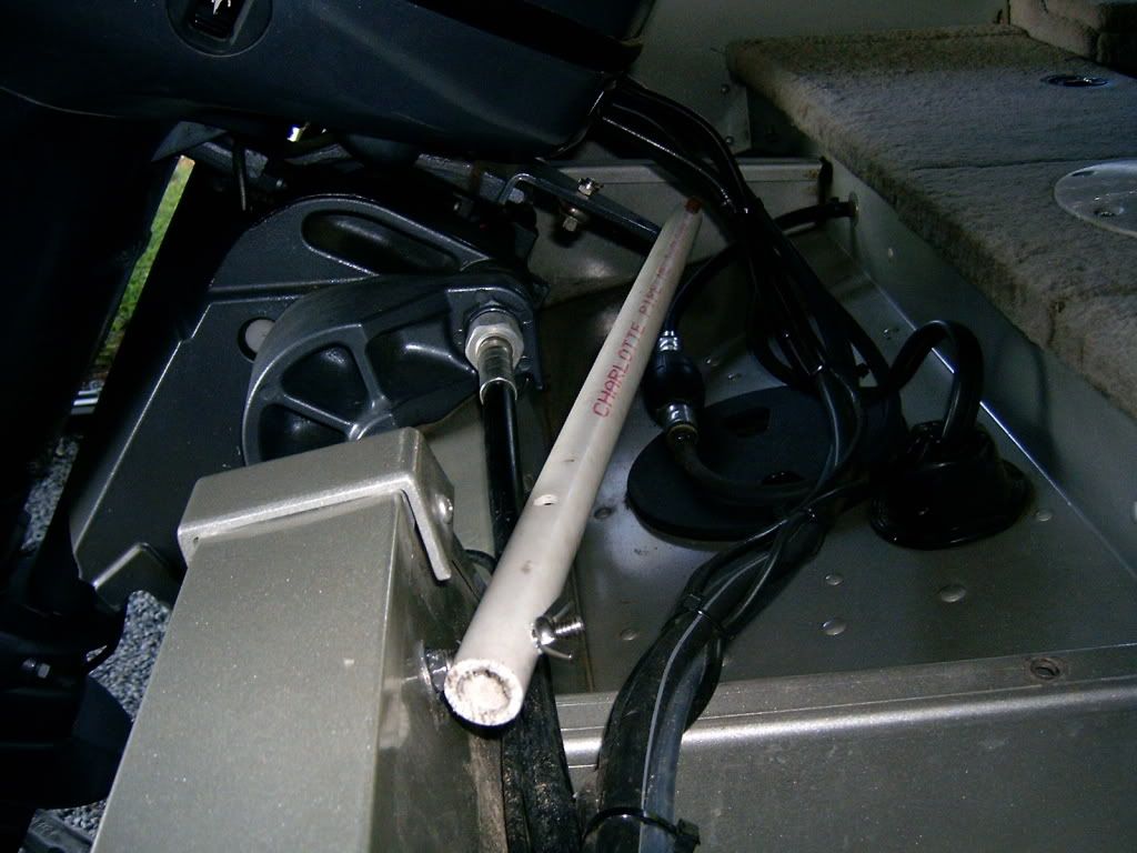

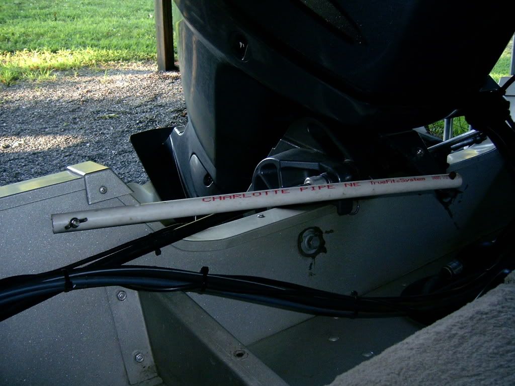

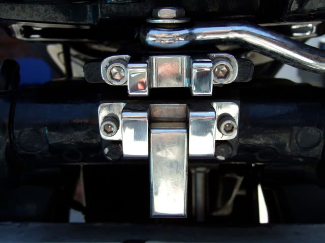

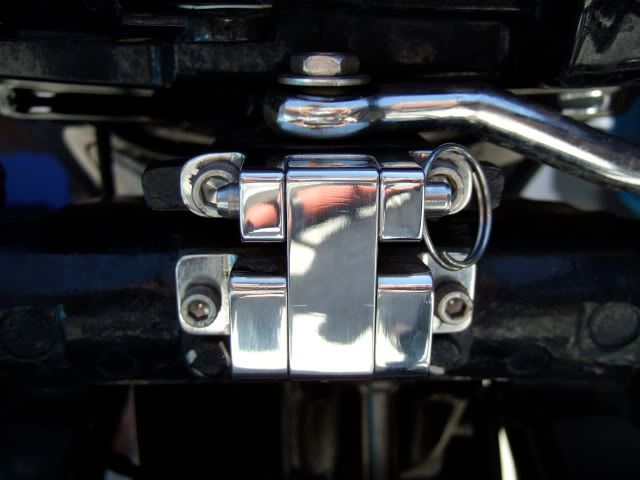

This what I eventually did to hold the motor centered while trailering
Custom made a SS bracket that swivels up to lock it in place with a spring loaded pin
Bolted onto the holes where the hydraulic steering would bolt to
Pull the pin and swing it down once I get to my destination to steer the boat
Don't ask where you can get one because it is one of a kind as far as I know.
Someone should start manufacturing these. There may be a decent market for them.
