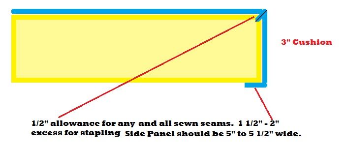

If you're sewing you also need to allow 1/2" for your seams. This drawing might help...
I like to use 1/2" strips of ShoeBox cardboard and roll the vinyl onto the cardboard prior to stapling it. Give it a much better chance of not tearing and give a much straighter and more uniform stretch. You will have a bit of a stretch to the final fit but don't over do it. I used Donor Couch foam. Cut the foam 1/2" larger than the Plywood bases so it will "Fill Out" your covers. Also cover the foam with Plastic to protect it from the abrasion from the vinyl.
