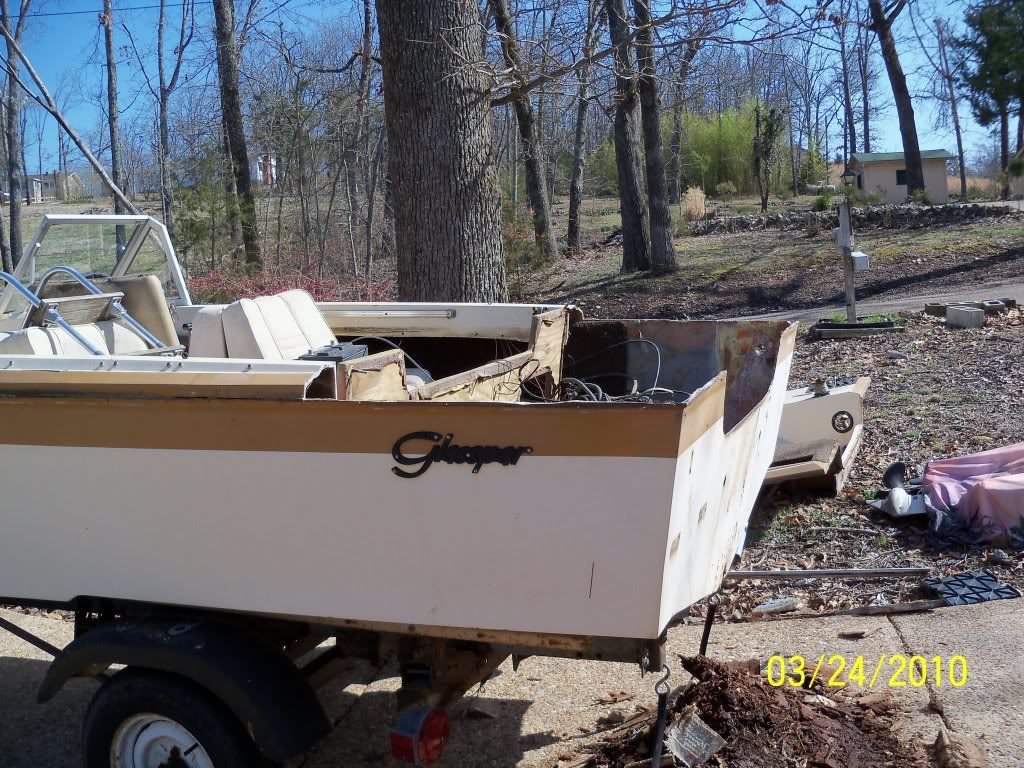

Well I am Travis. I am 29 and live in mtn home arkansas. I bought 3 boats this winter all for great deals. Two of the boats I got where the exact same.
I ended up moving from 5 hours away so I had to sell two boats. anyways so I ended up with a boat and lots of parts and after selling what was left of the other two I have made all my money back.
I was so excited that I would have a boat on the water this summer and it was free. Well I just found out that the transom is bad and am bummed.
I started to pull it apart today. So this is the reason I am joining this forum as I am sure to need help along the way. Thanks in advance.
Just one quick question so far: When u split the top from the bottom is a saw needed? I guess I need to use a few wedges to separate the two as I cut?

AAAARRRGGGHHH..........dont cut !
welcome to i boats......we can help you.
but we need more info.
on most boats the cap is riveted on under the rub rail....
depending on the boat you might not even have to remove the cap to get at the transom....
we need pics.

I agree with oops, don't cut. The rub rail is usually has a rubber strip. This rubber strip can be pulled on and removed which will expose either rivets, screws or both, remove these and the rail will become free. With some prying the cap should separate from the hull, might be some adhesive/sealant holding it as well.

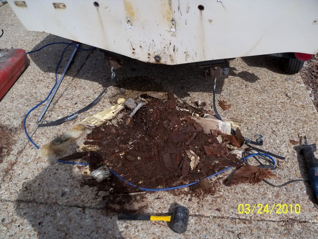

Ha no the plate thing came to mind till I got a better look. I did cut some but not the seam.

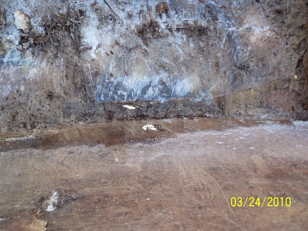

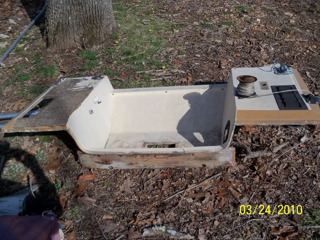

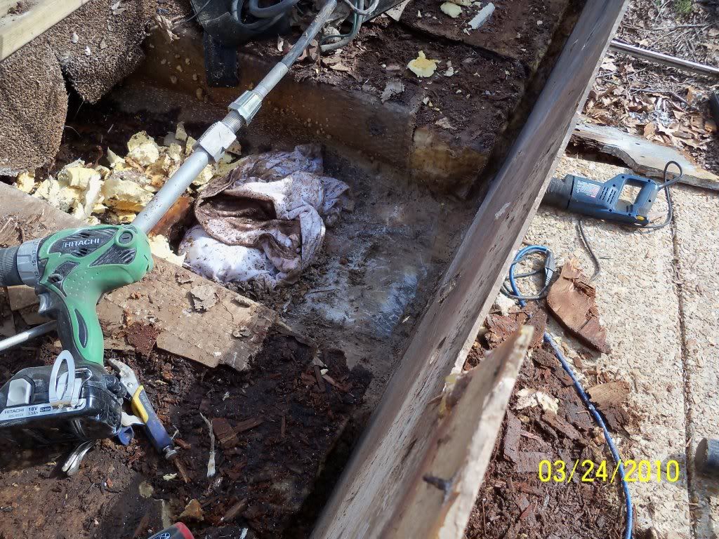

I tried to get all the fiber glass out to make room for the new but ended up putting a couple of holes in the bottom of the boat so would it work to just sand whats left and glass over? The last pic shows the spot where I sanded.

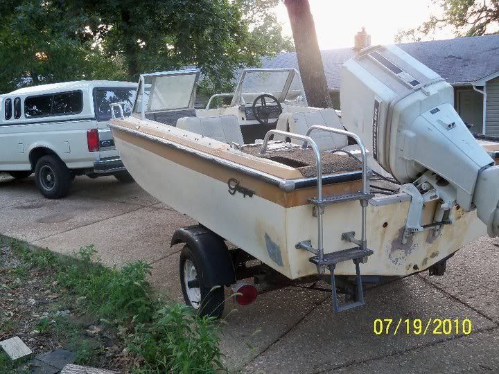

Here is some of the pictures we took last year. Thought it would be fun to post some.
As you can see we had a blast every time we took it out. I have been looking for a hull and nothing has come up yet. Money is very tight and even with the lake being 5 miles down the road its hard to afford to go so finding a boat in our price range is the hard part really. Basscat is making boats now with fiberglass stringers so im sure most everyone else stopped using wood also. Wood. What a stupid idea. Who knows when ill be able to get one with the glass stringers. Maybe 20 years?

Im gonna do a little Iboats "picture" addition here...
Pics #1+#3+#5=0 boat .. Dont risk it ..
I dont even know what to say..so I wont..
