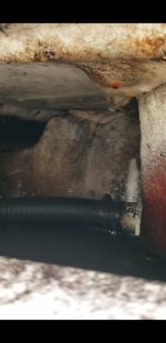

So, on the 215 Osprey Sports the deck drains into the engine well which in theory sounds great but then there are the two fish boxes that are nearby. Even with the boat tilted pretty good on the trailer it doesn't drain well and water back up and will fill up the fish boxes. Doesn't seem too bad but I live in New Jersey and the water will freeze in the boxes as well as the related tubing and macerator pump.
What I'm trying to do is brain storm a bit with your help on either draining the deck better

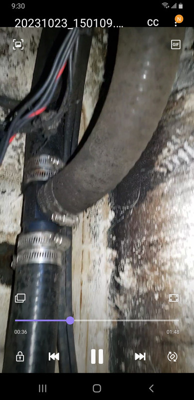

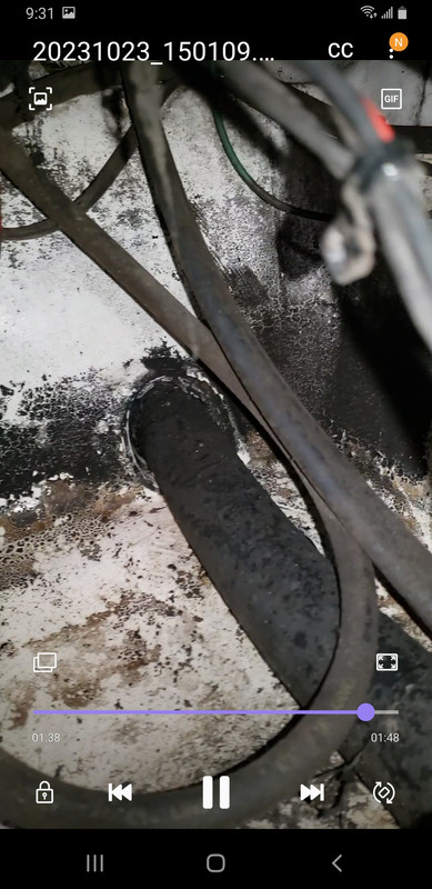

1st two photos are the deck drain in the hull and where it exits into the engine well. The other is the fitting on the fish box exiting under the deck.

If the rest of your drains (uv rot and cracked) are in as bad a shape as those posted, you have bigger problems than water freezing in the bottoms of fish boxes.
FWIW..I've never winterize the live wells, fish boxed or deck drains.
The water in the low spots of the hoses will freeze, but nothing to worry about since the passage ways are open ended, large ID hoses that can't trap enough water to cause freeze damage.
If your that worried about it, pour some potable, RV antifreeze in them and your good
