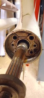

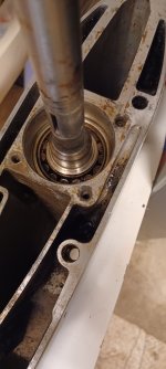

Before I brake something.. Is there anything Holding This thing together Other then the obvious?
I removed all the Bolts Water pump Plates Cover I can see the Bearing on the Drive shaft and the bearing is loose but it isn't coming out. I just want to verify that I'm not missing something before I force this thing apart. Same with the Output shaft Its not moving either.

The year is probably right. Get a parts diagram.
Called drive shaft and prop shaft.
The carrier on prop shaft should just pull out.
The drive shaft won't come out until the pinion gear/nut is removed.
Why take it apart???

It won't Turn, Frozen.
Supposedly it ran 6 months ago..
The Force power
Feb 3, 2019
2,359
What Happens if #32 is unscrewed?
It is already out!
The Coupling (#49) will have come loose and Yoke/Shift-pin has fallen inside the LU
You'll have to remove the gear assembly reverse/prop-shaft/dog-clutch but you can leave the Drive-shaft/pinion-gear and forward-gear.
Tilt the Lower-unit with the opening to the sky and move it around, with aid of a flashlight you will find the Yoke that has fallen off the shift-pin when the Pivot-pin(#32) was accidentally removed.
Now the tricky part (as the yoke is not magnetic) to fish it out trough the prop shaft opening from the forward-gear.
Once the pivot-pin is back in its place and the Coupling moves back and forth as it should, apply a small amount of marine-grease on the yoke/shift-pin(to keep it from falling off) also make sure the yoke's opening is facing down
Have the coupling facing toward the shift-pin and yoke(moving it in place by puling/pushing the Shift-shaft
now slowly start pushing the prop-shaft and all parts attached into the lower-unit.
Make sure!! the yoke lines up with the coupler behind the forward-gear, when it latches together; you'll see the shift-shaft come up
Patience & steady hands are required - results may vary
Good luck :)
