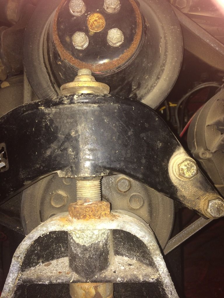

1966 v164 with 110 hp I-4. Front engine mount missing looks like it's missing a part. There is a gap between the bracket and the washer at the top 1/4" I can lift the engine up a little but the drive shaft seems to move freely in and out of the coupling so I don't know if I should leave it alone or not. When I look at the part diagram it shows two washers that are supposed to be on the other side of the mounting bracket but I don't see any on mine. So from the top down I have a nut, washer, 1/4" gap, bracket with bushing(s) then nothing until adjusting lock nuts. For some reason I can't post a picture.

1966 v164 with 110 hp I-4. Front engine mount missing looks like it's missing a part. There is a gap between the bracket and the washer at the top 1/4"...
I think you are supposed to have a sort of fiber washer in that gap - vibration damping would be my guess

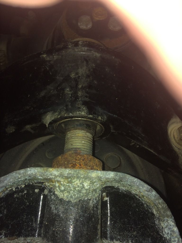

The second photo is the underside and I'm wondering if that's right. It appears I need to add a spacer. I just don't know if I add it to the top or underside. I think they washer(s) are missing from the underside and I don't know if that is ok because I don't know what it's sitting on if there's no washer.

Not sure how yours is "supposed" to look like on the bottom (being a 110), but my 120 has a fiber "washer" on both the top and the bottom of the mount, as a cushion between the mount and the steel washers. And yes, mine has a flat washer on the bottom - but yours "might" be different. Do a Google search for those mounts and you'll see what I mean.

The part diagram shows 2 washers at the bottom for this style. I'm just trying to make sure I'm actually missing them and they weren't up inside the bracket where I couldn't see them. Anyone know the dimensions of the flat washer?
