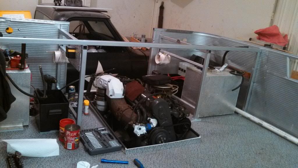

icyveins
Aug 7, 2013
156
Re: fuel fill location
[URL=http://s174.photobucket.com/user/HDspringer05/media/BOOOOYAAA180-Copy1.jpg.html] [/URL]
as you can somewhat see in this pic the fuel tanks, one 14 gal on each side, what I am fighting is the height of the rail. the top of the rail is only about 6-10 inches above the top of the tank not the fill neck. so without a lot of height to play with and still have "fall" on the inlet hose. that is why I would like to mount them with the fill cap pointing straight up in the air so when you are pouring out of a can or nozzle it will easier then having the fill on the side of the boat
