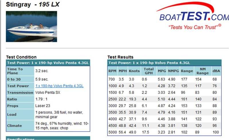

Boattest.com is your best friend for these questions.

around 3.5 gph of average play - tubing skiing etc..... that's what i get in a stingray 190 with the 4.3 which for me equates to about 10 gallons a day, between swimming & floating.

The post above is a good example of why you want to look at the data yourself. 3.5 GPH won't even get a 19' Stingray with a 4.3L on plane.
However, if you include the time the boat's not running in your average like the above poster, you can make the numbers say anything you want. My 30' Searay with twin 5.7L also averages about 3.5 GPH for an average day's use.
