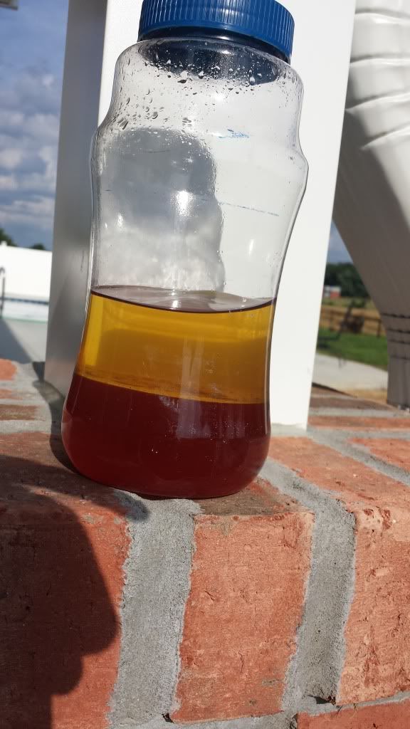

sheeeeeet. Been having issues with stalling at low RPM. When I bought the boat that had been sitting for a few years I bought 10 inline fuel filters to work thru the crud. Been thru 9 of them.
Last time out, because of stalling I checked that and all good. Didn't think about the water/fuel separator.
Two things:
dam there was a lot of orange fuel in there (rust)
half of what I poured out was water. I've only used ethanol a couple times, maybe 10% of the time and when I did the dude said their additives made it 'ok'. dammmmm....
Ordered four new ones from iboats just now.
Disclaimer - they were the cheapest, with shipping, I found quickly. Thank you.

Sounds like you need to drain and clean the fuel tank, if the orange is truly rust then time to replace that tank. You can keep spending money on trial and error items or bite the bullet and replace that tank.

That is not condensation build up if it is 50%+- of the tank, you have a leak somewhere and I bet it is the O-ring around your gas cap thats missing or something along those lines.

I use the term rust for generic crud. Shouldn't be rust in an aluminum tank, just the varnish working its way out. Good news, if I do have to r/r the think it will be a one person, one day job.

new o-ring and we store under cover. The pic is not directly from the tank (which I will sample thanks for reminding me) rather from the separator.

Drain that sucker. It makes no sense to mess around with that much water/muck. Pour off the good gas, if there is any and reuse.

RNJ - You're going end up biting the bullet and draining the tank. Your fuel tank isn't half full of water, but the pickup is on the bottom of the tank where the water is. So separator draining will be always showing water until you purge the tank. Even the best additives have limitations.
Do you have a portable tank? Running on a portable with known good fuel will tell you plenty and pinpoint bad/watered down fuel as the culprit for the stalling.
PS - Don't buy a boat from the guy saying " their additives made it 'ok'." I'm not saying his nose is growing, but you could probably hang dock lines on it.

Before pumping out the entire tank;
Collect a sample of the fuel in a jar.
Fresh fuel is Clear and Light Yellow in color and will loose its foamy "Head" when shaken in less than 5 seconds.
If it has water in it, it will be Milky/Opaque looking.
If it is badly Oxidized and full of "Gum", it will be Amber/Rusty Colored and hold a "Head" for 10 seconds or much longer.
Test it before you blindly dispose of it!
Adding fresh gas to dilute it at least 1:1 will often clear up any problems.
