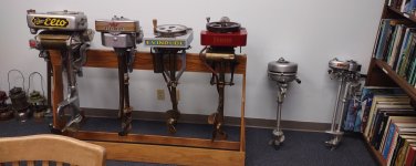

If your just idling around just use very little oil (100 to 1)
If you want to rip around use 16 to 1....
Otherwise use 0 to 1 and put them on the wall. Years of staring at them will do you wonders.

Yes, I can make just about any 2 stroke outboard run excellent on 100 to 1. And I have a 63 brass British Seagull that runs on 16 to 1.
I just really thought, starting them once and then hang them on the wall and maintain them is WAY more fun the running them around at high speeds.
I believe they'd lived a good life and deserve to be put out to stud!
