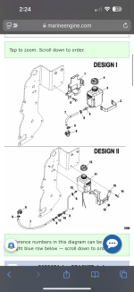

Anyone got a picture of what it’s supposed to look like, seems like i’m missing some hardware.

alldodge
Mar 8, 2009
42,621
The gear lube fitting broke off and was not replaced, so a band-aid was installed.
You need part 861150T02 or if you can find the old style which was all brass
