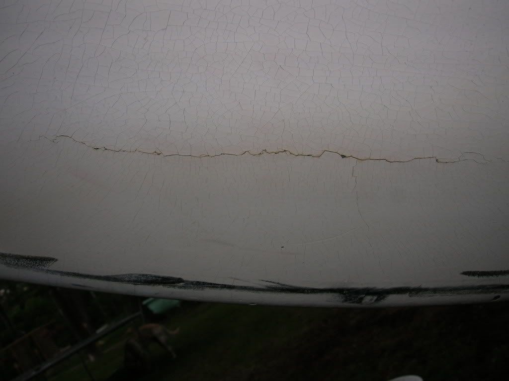

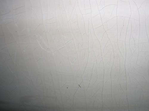

These are the cracks like hair line....
This is the only one thats bigger ... Its not raelly big though....

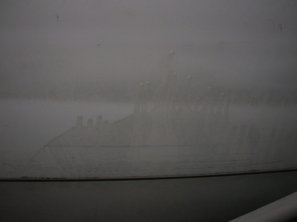

Could this sag be from someone elses gel coat? Or would it just be paint??

All of the small cracking is from poorly applied gel coat and is only cosmetic. The longer, darker crack looks it like was from an impact or sharp flexing, if you can see it from the other side you should be able to tell how bad it is. If it's above the water line it may not be a problem, but try to inspect it a little more.
