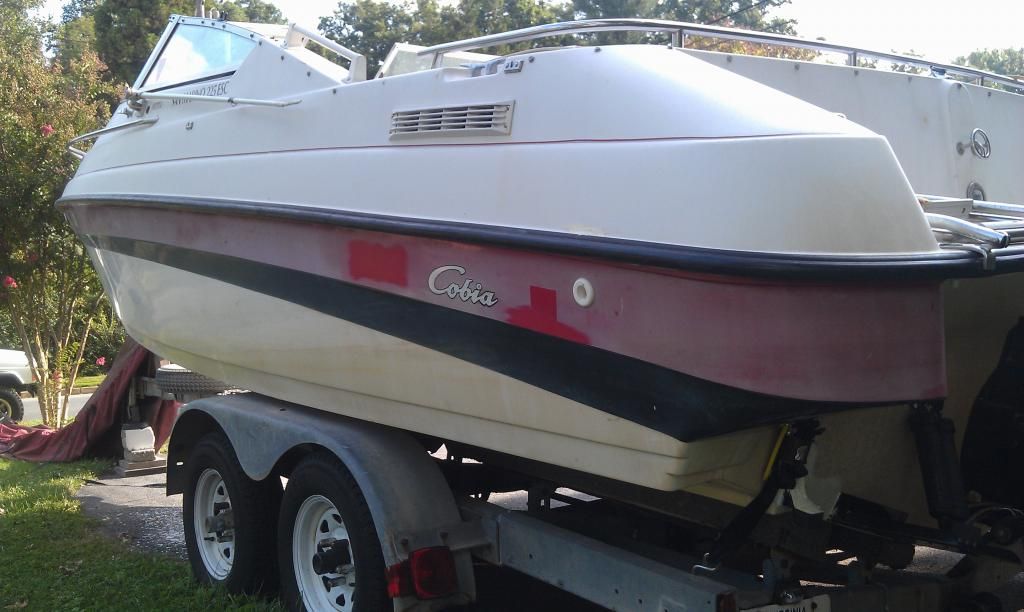

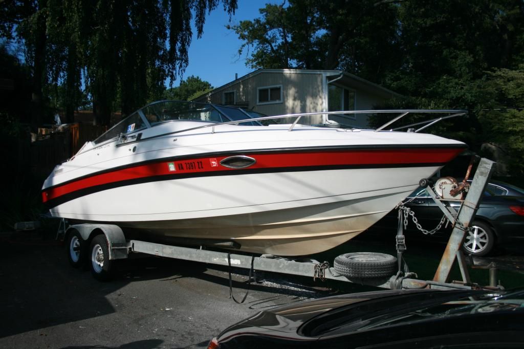

No amount of polishing compound, wax or 'gelcoat restoration' product could fix my oxidation issues. After hours of meticulously using these products, I ended up with a gelcoat that looked slightly brighter and was back to being faded/oxidized after a week or so. I saw someone on here post that the best product to remove oxidation from gelcoat is sandpaper, so I tried it in a couple spots..
The results were exciting so I started working..

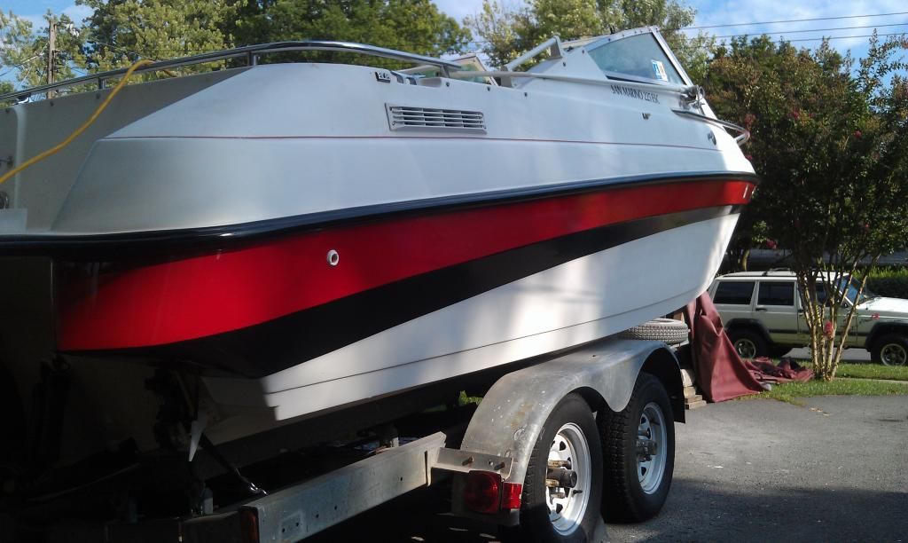

I worked all day and actually to my surprise, it looks like a new boat. Even my quiet neighbors stopped by to comment on how nice it looks.
I'm half done, going to start on the other side today!

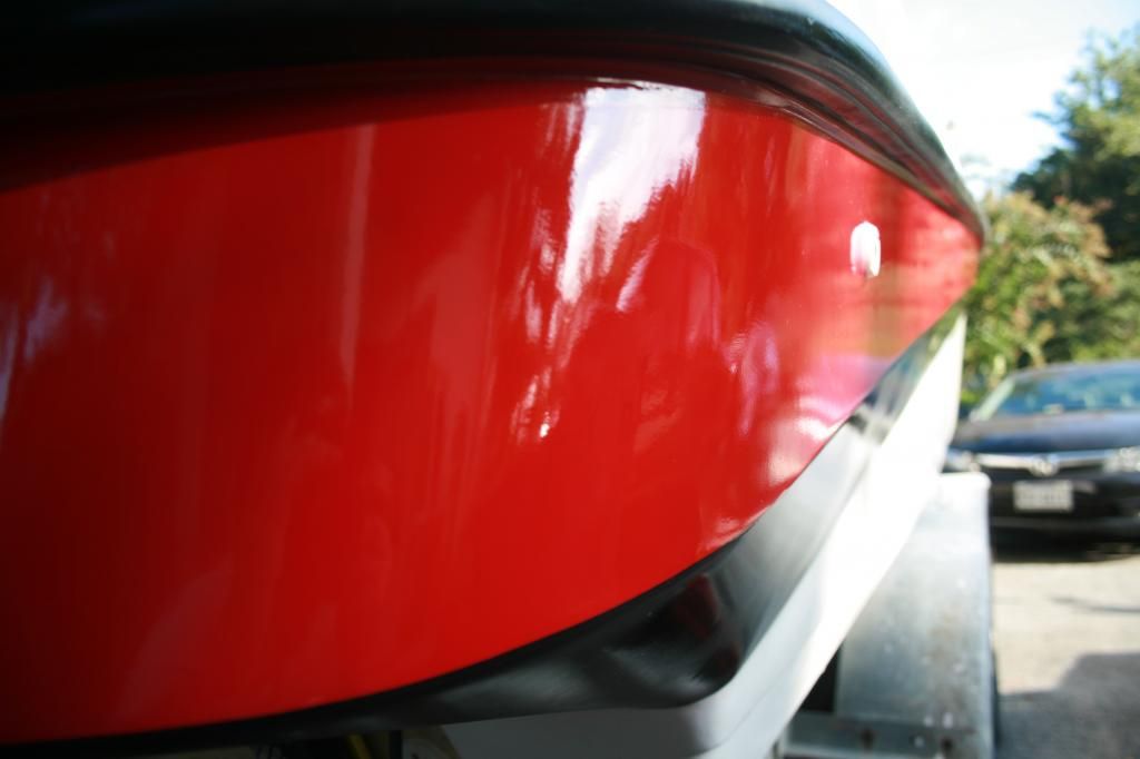

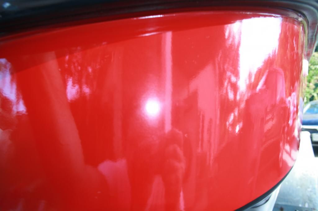

Actually, I did it on a tight budget. I used 220 grit sandpaper on a triangular finishing sander, and cleaned it with lots and lots of acetone. You can see the oxidized part being sanded away as you go and once you get to good vibrant gelcoat you can see the sanded particles change color. When all the dust is the original color and not whitish clear, you know you've sanded enough.
I didn't wet sand it but I did spray it with a good quality automotive clearcoat (from a can) after cleaning. First I tried to sand with a 5" disc sander and found that worked but didn't leave an even finish. Then I remembered I had the finishing sander and now that I tried that, you couldn't pry it away from me.
The oxidation was soo thick that sanding with ultra fine sandpaper would have been pointless. I had to sand pretty deep with the 220 grit in order to restore the color but it sure does look good now.
My supplies for doing the one side were, finish sander ($30 at the home depot), 220 grit finish sander pads ($5), 4 cans of krylon acrylic ultra high quality clearcoat spray cans ($20), and one quart of acetone ($10)
I did waste some supplies trying to figure out what worked best but it still wasn't pricey for the results.

Yes, I made sure to buy the more expensive clear coat that claimed to have UV protection and won't turn yellow, I guess we'll see how good it is. I tried to buff the gelcoat first and I went to town polishing and polishing and polishing and though the color came back it just didn't shine like I wanted. That's when I tried the clear coat.
And like jig said, if it doesn't work out, I still got my sander :)

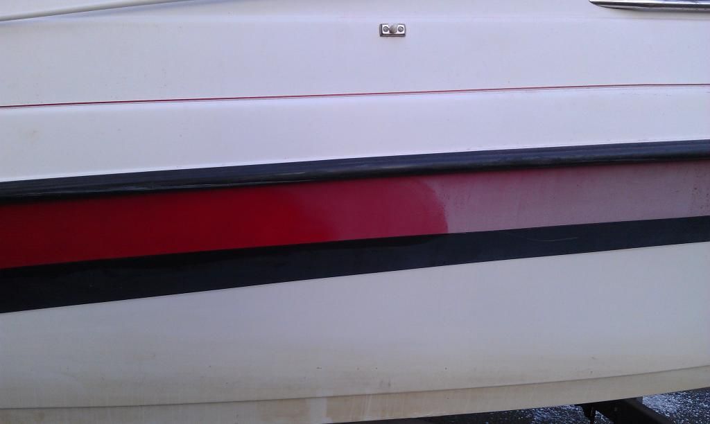

I understand what you are saying. I already did try to polish and wetsand the gelcoat further after initially sanding it BEFORE clear coat. Sanding and polishing ONLY was my original intention. I spent most of the day sanding away the oxidation, then trying trying to polish and wetsand it for a shine from the gelcoat only. This is what I WANT as I hate clear coat and paint in general, I much prefer working with gelcoat only. There was so much oxidation that by the time the color started coming back, I had sanded almost completely through the red gelcoat. I could see it getting thin in spots and made the decision to stop all sanding as I didn't want to loose the color.
The problem is that I was able to get the color back (with polishing/wetsand) but it didn't shine, that may be due to how much had to be sanded away, I don't know for sure. I considered my options and decided I would try a quality spray clear coat since I would just be doing the colored red/black part. If it doesn't last, I'll be sanding it back down and probably applying new gelcoat to the colored areas to thicken it up.

In the second picture here you can see what it looked like after wetsanding and polishing, the color returned but little to no shine. I tried hand polishing, buffer polishing and random orbital buffer polishing. The portion to the right is unsanded, unpolished, the middle portion is unsanded but polished, the left portion is sanded and polished.

I went ahead and finished the rest of the boat. There's only clear coat on the colored areas. It may be unconventional but it does look good, we'll see if it lasts.
