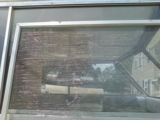

Can anyone tell me how to get the screens out of a chieftain 25ft. seems the window's don't come all the way back and don't want to mess up the frames to them.

Don't know off the top of my head, but will take a peek at mine tomorrow and see if I can figure it out. The windows on mine only slide back about a foot and half; How far are yours opening?

about the same I thought the strip between the windows with screws on the outside removed screws but couldn't get them loose. Thanks

Just remove the 4 screws and they come out.Had to slide mine forward a bit before they would come out though.

LOL caught a swam of bees today (guess I look stupid running all over the field but I finally got them.) The screen's came out one in three peices and the other sort of bend I do believe they have been in there since 73. Well I will drop off the frames and have a couple made.
