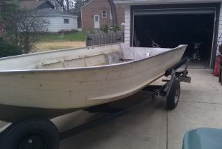

So I'm getting ready to paint my 16' Tracker and I've read a ton about painting aluminum but I want to make sure that the various combinations of what I've read along with some of the specs on the paint that I'm using (Rustoleum Marine Top Side) all coincide with the process I'm planning to use. First off, here's the boat (before):
http://i801.photobucket.com/albums/yy294/tabsher1/Boat and Trailer Restoration/100_1942.jpg

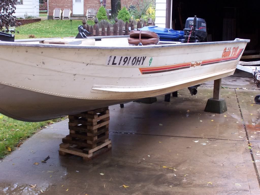

And here's how it looks today, after having stripped all the decals and reg. numbers:
There are a few spots of bare aluminum but the rest is the original paint and seems to be in pretty good shape.
