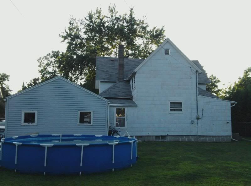

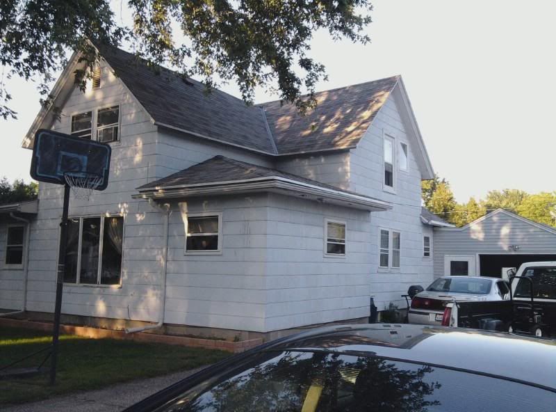

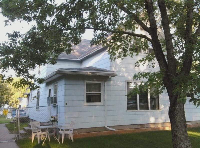

Here's the 4 corners of the house.

I do have a fishing net upstairs here to catch them.
On the upside. Under the eves there is wire mesh so they are not getting through there.
The only place I can see that they may be getting through..
In the pic with the Pool and full chimney stack. On the backside of the chimney they roofing cement looks like it's pulled away about 1/2 inch. Then along the flatter part of the roof there's a section of the siding that's pulled out about an inch on the bottom. (Figuring the ice dam did that one).

The fact that your house has siding is good indicator your problem will be easy to fix.
I see a few different areas you should be looking at, but my guess is going to be that chimney. In the pool picture the chimney contacts 2 levels of roof, the areas where one roof tucks up under the second can often leave a small gap due to the contractors inability to get under there to secure things, or often things get dislodged while a roof is being replaced.
Bats need a porous surface to land on, your house has two of them, one is the shingles on the roof, the other is that chimney. To gain flight a bat needs to drop, it is very difficult for one to simply leave the ground like a bird, again bringing attention to the chimney.
Do not block holes! If there are bats in there you may block them in and create a whole new problem.
When you are on your roof look at the areas where the roof lines meet up like that triple roof line below the chimney, as well as the one above the 2nd back door closest to the camera in the picture below the pool picture.
Once you find the main entry hole you will see evidence of bats. Like every other airborne animal they do their business before they take to the air to lighten the load before flight. This will be evident by droppings accumulating below the entry hole. And I am guessing you will find it around that chimney or the flashing by that second back door, or both.
Here is an example, this is a church I did yesterday, this is below the entry hole, a bit extreme, but gives you an idea of what your after:
Before you address the main hole you need to deal with any others, or they will simply relocate to a second hole once evicted from the first. If they are using the vents, and I have my doubts, you will see droppings on the wall each morning. Most of the guano will wash or blow away but some will still be there protected from the elements by the way your home is built. Have a look around that chimney for droppings, when you find them take a close up photo and I will build you a device to get them out.
Also not a bad idea to do some research on co-existing with bats, or the guano left behind by them. Bats are pretty harmless, but the guano can be pretty deadly stuff, from the construction of your home I don't see that being an issue though. The amount of droppings you find out there (at the entry hole) will be a great indicator as to the quantity, so try to include that in your picture.
