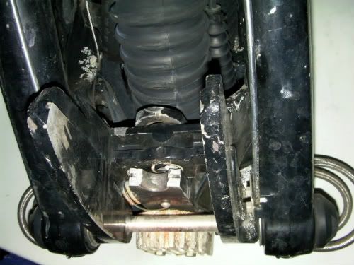

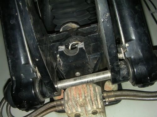

i was winterizing my boat after my final trip of the season and found this
what would cause this to happen?
it was fine before my last trip
i did NOT impact anything
no other dammage
what eaxatly is the part called that is broken is it the gimble houseing or the bell housing or something else
alpha 1 gen 1

Hitting something in the water , defective casting
I think its the transom housing ,steering ring looks intact but the lower pin is gone

That could have been from a prior mishap. It is the gimbal housing . . . Cost is approx $1,200 for the part; Labor may be similar $$$. Perhaps could be repaired by a good welder/machine shop for less.

Sucks its not a gen II, I got one I would have sold you on the down low although its not perfect either.
That could have been a under lying problem since it broke where the cotter pin goes through. You could have hit something a long time ago and it just now rear its head.
And when tpenfield said good welder/machine shop, Im sure he meant a GOOD welder, not your local farmer.
Its either cast aluminum or perhaps cast iron (doubt it tho). Which means a PITA to weld, although it can be done with the right tools and the right person. Most people wont touch it tho, and the ones that will, more than likely will mess it up. But hey, it aint no use to you as it is now. You cant break whats already broke.
