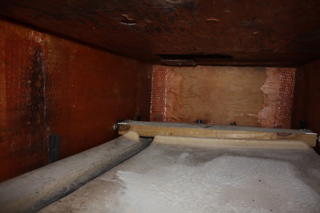

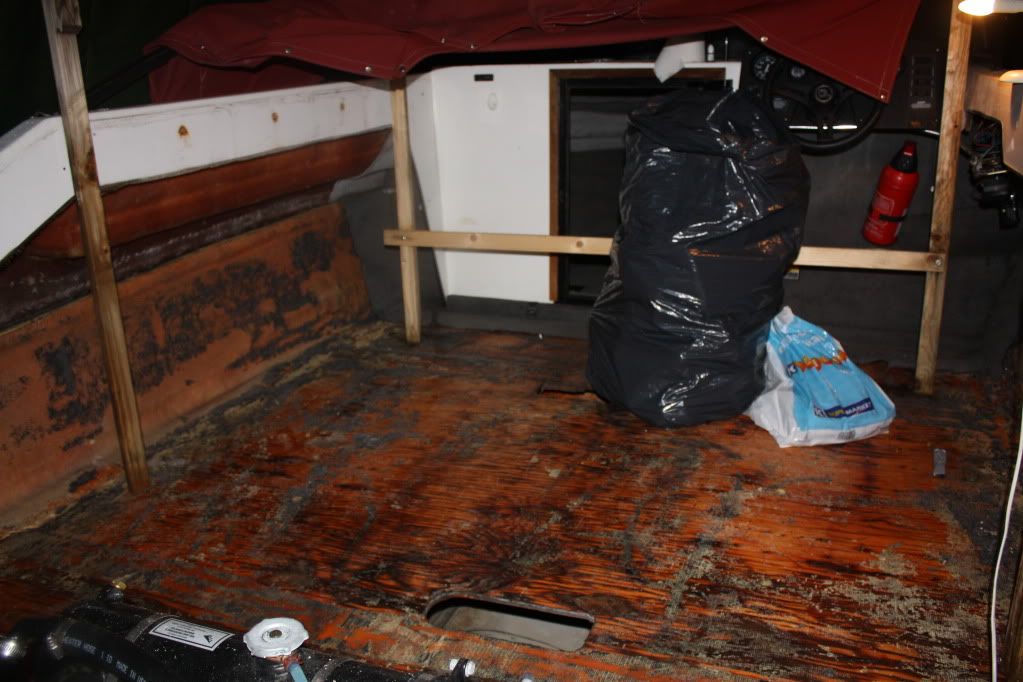

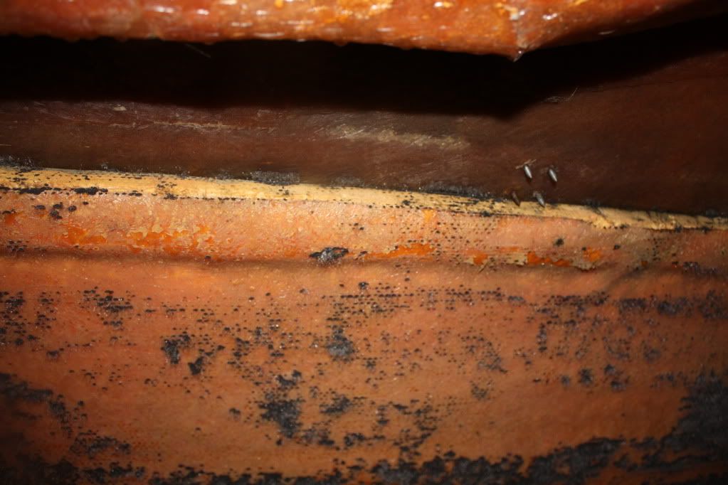

I have done some investigation on the hull.

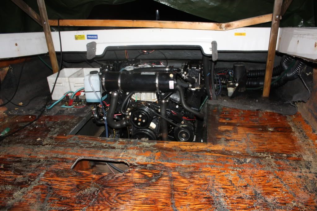

-The transom only has some rot at the bottom part,the wood at the drain plug was only painted to protect from moisture.But it obviuosly needs to be replaced completely.
-The stringers actually seem to be in quite good shape,all the test drills came out dry with solid wood.I found a dark colored spot in the wood(clear resin) at the gas tank area,so I have to inspect that further once I can remove the deck.
My plan is to remove the rear part of the stringers from the gastank to the transom,and only redo them along with the transom.This boat actually had 3.0 merc initially and was later replaced with a 4.3.The improvised engine mounts are not good and needs to be redone.I have decided to use nidabond for the transom.
-As the deck will be replaced I want to remove all the foam and replace it with 2k pu foam.Hopefully I can leave the floor in the cuddy alone,and just seam the old and new deck near the cuddy "wall"

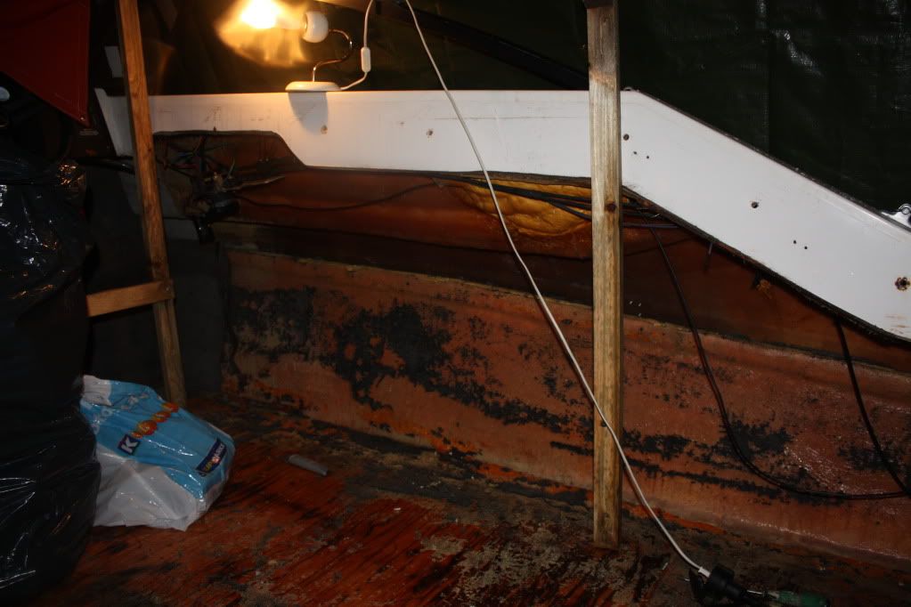

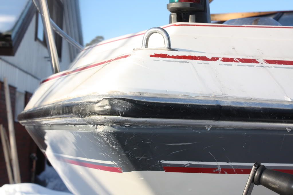

-The boat has got some sort of impact on the port side that has made spider cracks.Those will obviously need to be ground and filled.There are some single cracks in the gelcoat that also needs to be fixed

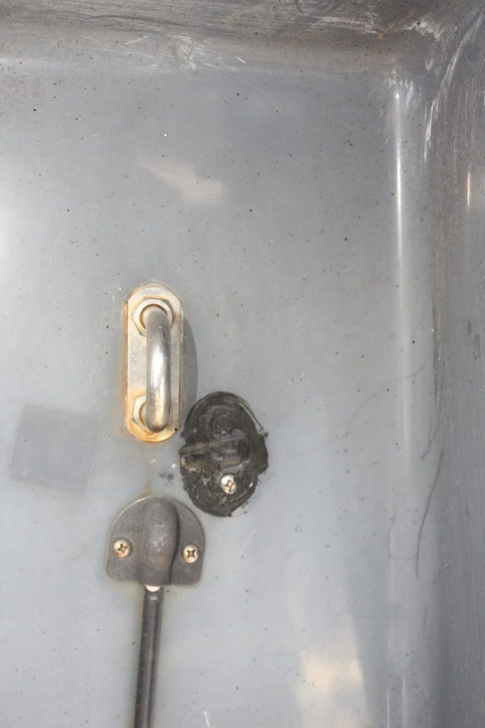

-The engine room vents are gone.Some moron put a windshield viper on this boat that has left a hole in the cap
.Also I will remove the radio antenna as I dont need it.All these holes will need to be "rewalled".Dont worry I will redo the vents with a different style
-The screws that attach the rubrail are spinning,the wood behind them is slightly rotten.
-There is a small impact damage in the bow with exposed glass that needs to be redone
-The gelcoat is oxidized and very dirty.The boat had a very nice shine when I bought it so Im positive it can be polished with some elbow grease.

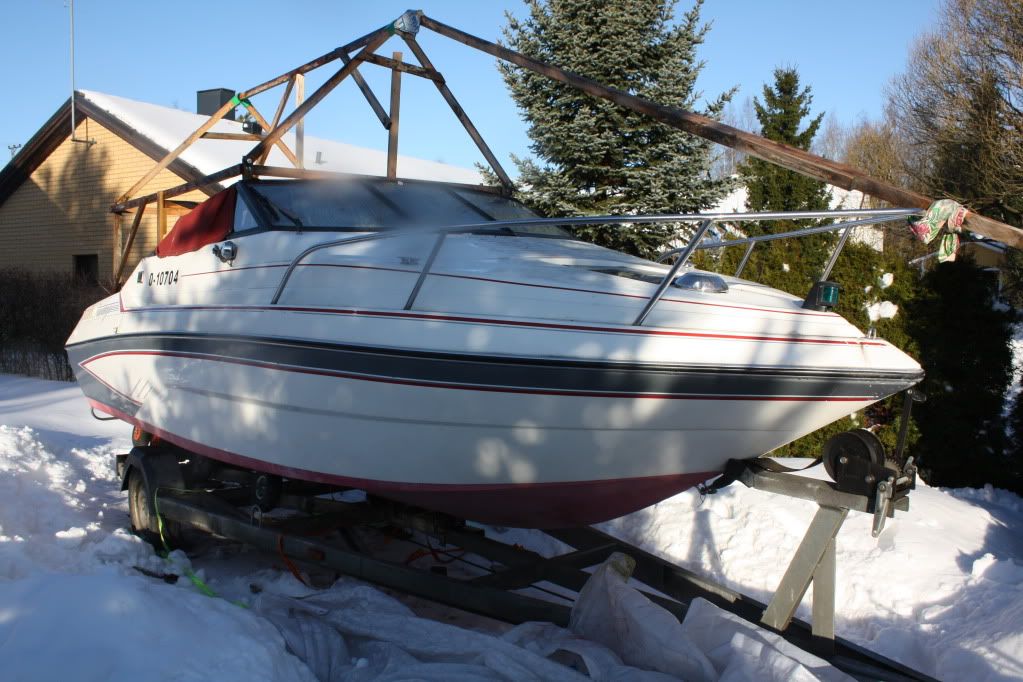

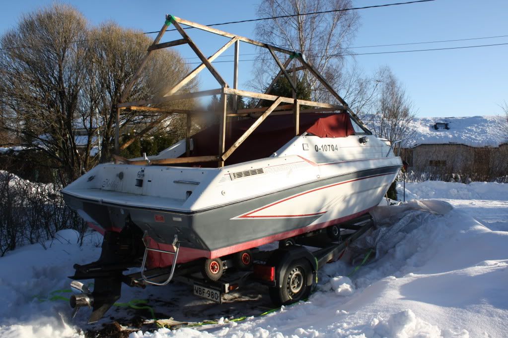

In its Current state
