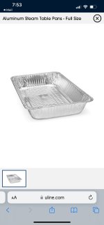

Correct. What you see is the outside of the "tub" the fuel tank sits in. Think of an aluminum baking tin. Very similar in shape. There is what seems like a small strip of 1/2" plywood ~1" wide glued to the bottom of the lip of the tub, which I assume was put there to provide backing for the screws that once held down the hatch over the fuel tank.
No evidence that a full depth stringer was ever present. No rotted wood, just foam. Foam also travels from side to side under the front edge of the tub, Highlighted in red. Hopefully I'm doing a good job describing it. Very odd to me. I was expecting it to look like the underside of a home floor, but it does not.
