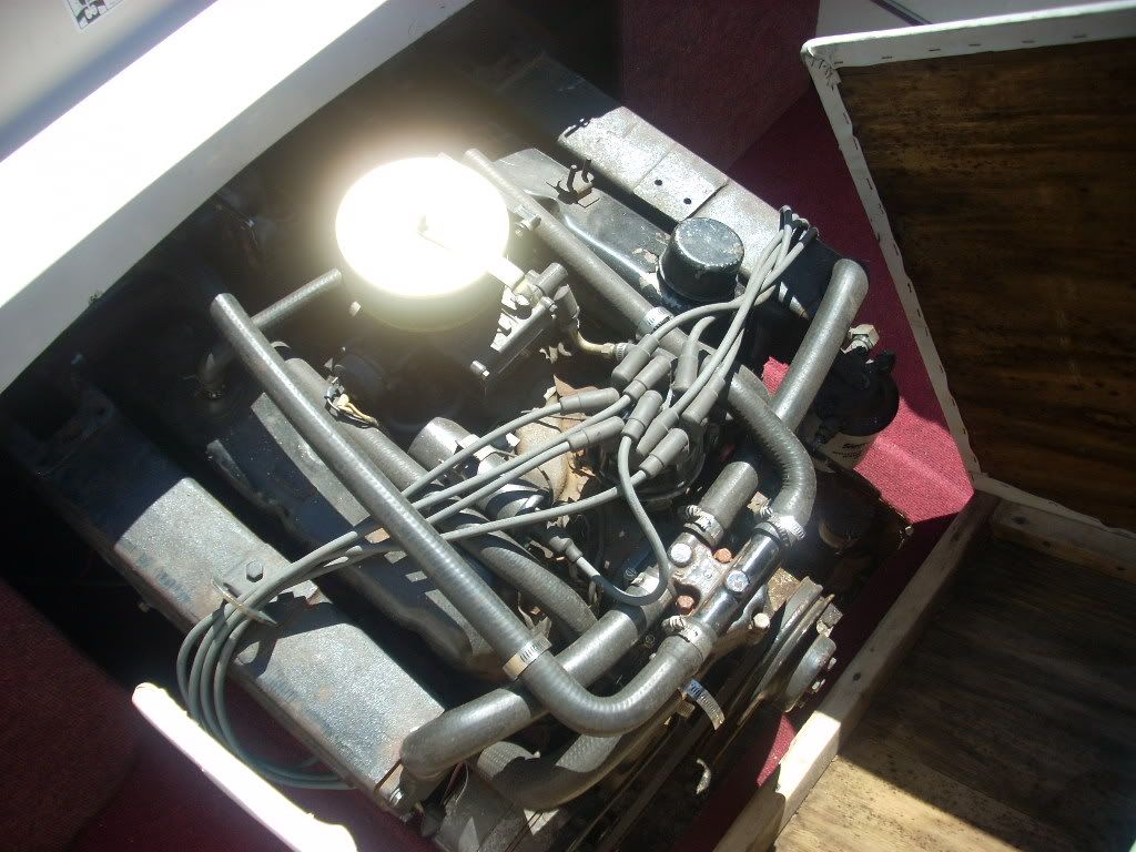

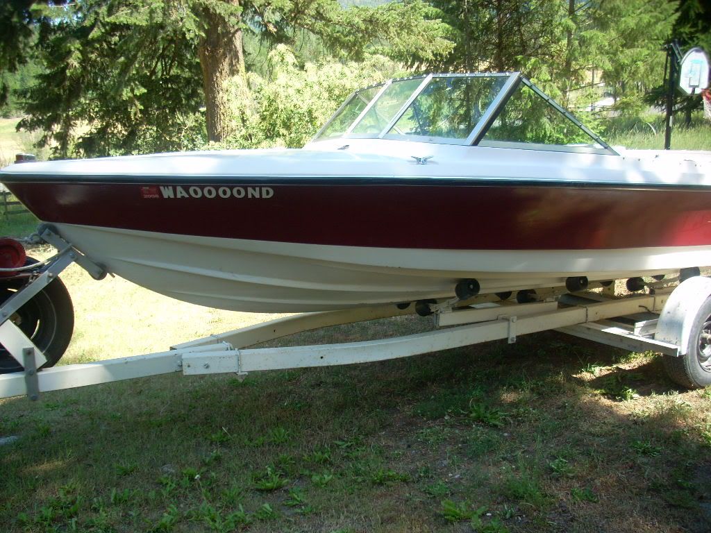

well lets see if i can shoot ya guys some pics of the ol tub:D
not bad for a thirty+yr old boat
shot of the merc 888 hope its okay
hooked to a 302 how cool is that
/s151/jackcarlson1965/077.jpg[/IMG]

gotta wonder about someone that mounts a cake pan under somthing so they dont soil the carpets:eek:
ezmobee
Mar 26, 2007
23,767
Re: going ta go look at a boat
Looks great. You got a very good deal there.
