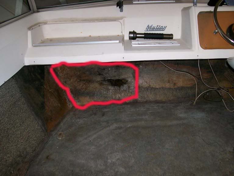

But when i was cleaning it out today i noticed some more rot in the bow below the dash. There's about 8 inches of space between the top of the boat where the wiring for lights runs and the eye's bolt and where the lower fiberglass starts, i'm not even sure what this is called? Anyhow the rot is located on the wall from the boat floor to this "area."
Not being too familiar with boat construction, i'm not sure if this area in the bow is hollow? or full of foam? or what?

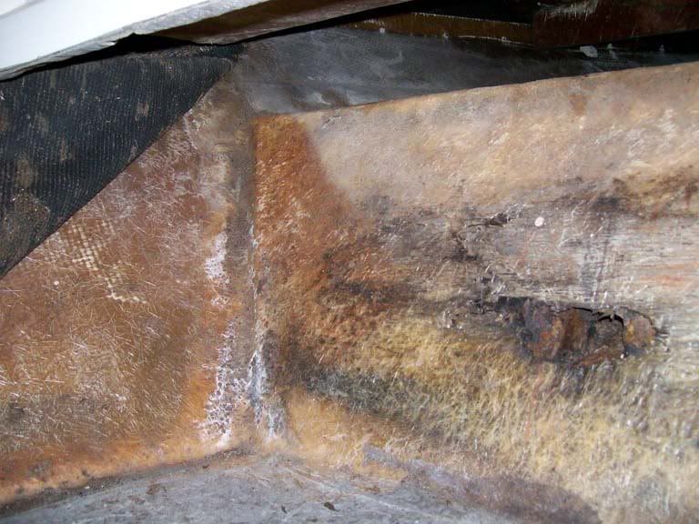

I'm posting a link to photobucket pics below so you can see what i'm talking about. The first photo shows what area is affected circled in red, only the left side seems to be soft, the right is solid.
and the second photo shows up close a spot where the rot has started a hole in the wall. it looks like a layer of fiberglass then wood and finally foam.

ok...the rot up front is easy....take a grinder and cut the whole vertical peice out...its tabbed in on the sides....be careful to not chew thru the hull.....
replace the wood with exterior grade plywood....whatever the thickness is of the wood coming out.....
and re glass it in with at least a 10 oz chopped strand matt....
but heres the catch....yer running a bayliner.....(one of my boats is a 89 capri 19 footer).....as you know ...bliners were a price point boat, so they were made cheaply......
you have issues on the transom and in an area that doesnt uasually have rot.....im afarid the rest of the boat might be rotted as well. this means stringers and flotation foam is wet as well......
