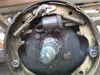

Pulled my brake drums today to inspect the bearings and brake shoes on my new purchase today, and found this mess:
They appear to be 10" Uniservo's from what I can tell. Anybody have an idea how much new shoes are or if the can be relined?The lining is riveted on. Having a hard time trying to find them online.Many thanks in advance for any info.

NAPA used to reline shoes and maybe a truck stop, but thats sort of a lost maintance thing these days.
Right off hand they look like the old standard chev truck shoes.

I pulled my trailer apart and my drum brakes are looking just like yours, your seal went bad, I ordered new seals/ 10" brake assembly and seal wear ring from Waymire Dist.

When mine went bad I just looked online at rock auto to see which truck had similar sized drum brakes. I think I replaced them with shoes from some year of Ford Ranger. I wish I would have wrote it down. There aren't that many different sizes, and the shoes are all the same for the most part. Just find the right diameter, and then width.
I also had to replace the brake cylinder. I think it came from a ranger too. Only difference was two pistons compared to a single. That one was more tricky. I remember comparing piston area so it would use the same amount of brake fluid to expand. Again, I wish I would have wrote down the part numbers.

Looks like you are also missing the forward piston rod on your wheel cylinder??

I maybe dumber than a box of rocks. But what activates the forward shoe.???
50,385
Re: Greasy Brake Shoes
the actuator pushes the one brake shoe which in turn pushes the second brake shoe.

I can't tell from the photo if the front shoe still has a good lining. If so, I'd just get some spray brake clean, replace the leaking seal, and put it back together. If the shoes actually need replacing, I recommend e-trailer.com. They have knowledgeable people who can track down trailer axle/brake parts for you at good prices.

You never want to clean grease soaked linings. Need new ones.

The linings are still good thickness wise, and appear to be new (still has blue striping on them). I called a local boat trailer dealer looking for new shoes, and explained the problem; his response was to clean them with brake cleaner, and scuff up the linings with sand paper.
