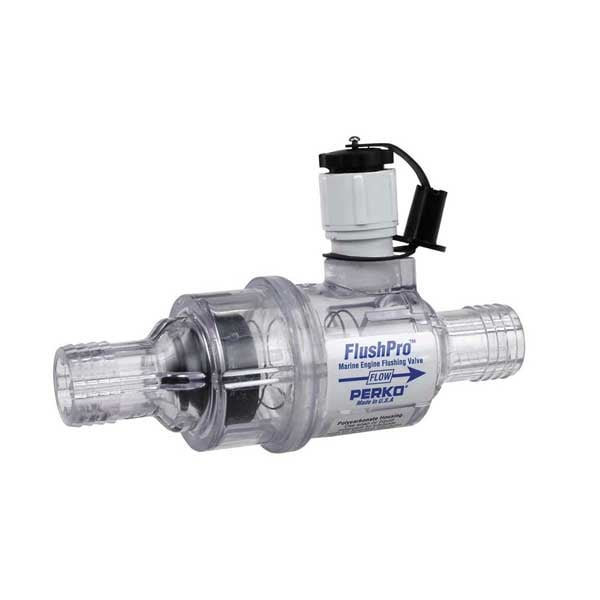

Also, and you may be aware already, but I was not: there are 2 different flush connection types on these motors (1) those that can be only used for flushing and (2) those that can be used in lieu of muffs, ie can run the motor on it (at idle + a little bit). See this post (link) and look at post numbers 87 thru 89. If you have the 2nd type (blue cap), you can go muff free in the future 😊

Sounds good. And you never defiantly said but since you are running on a hose (not muffs), your flushing hose connection is the blue cap style (see post 6) and picture below. Is this correct? (not trying to be rude, just double checking....)
And for reference, my 2005 5.0 GXi-E running on the blue cap flush connection at idle will hit 170F, takes a bit but its one of my preseason tests to make sure all is good.

If your engine has the blue cap, its designed to be used to flush the engine with the motor running. The VP manual says “Turn water on full and start the engine. Let the engine idle until engine temperature stabilized at its normal operating range.” So yes, its capable but obviously only so much as you are highlighting. I never run the motor up to full RPM but will bump it to 2000 and back with no issues. Been doing it for years and more than once during preseason (any time I do work on the motor, I run it on the flush port to temp).
It has a similar connection with a transom hook up. Both have been disabled to rule out air.
I am not familiar with your aftermarket setup but now I suspect possible improper hose routing may be causing the overheating (even if disabled). I am back to new to you boat and that perhaps you did not install this flush connection (yes, no?). If so, suggest go back to original OEM set up. Also, and need to ask, so do not take offence, are the RWP hoses on correctly? Its easy to get them switched.
