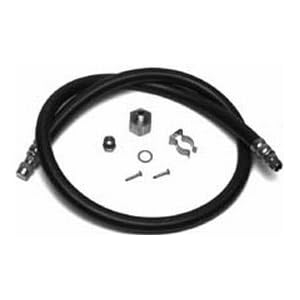

Okay so is there an easier way to change the oil in my boat. I've tried warming up the oil and go through the dip stick, but it goes very slooowwwly. I've tried to go through the oil pan but made more of a mess than I wanted to, it's too shallow to get anything in there.
I've seen a couple of things, such as a hose that hookes onto the oil plug. I'm curious to see if they work as their intended to.
Any advice on making this job a little less messy and more convenient.

Yes the hoses do work that you connect to the oil pan and stick the hose out the bilge drain.
A good suction pump works well too connected to the dipstick tube.
Does the tube have the threaded end the size of a garden hose?

I connected a pan drain hose on mine and permanently clamped it to the port riser.
Then I bought a Moeller vac pump.
I can drain the oil with 18 strokes and about 5 min hot or cold and not spill a drop!
