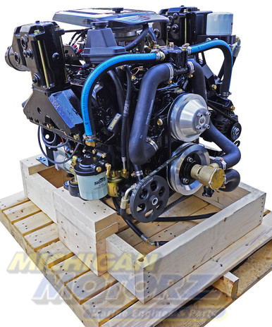

Ok getting tired of pulling the rear seats out to do the oil change on my old boat. I found that Michigan Motorz puts together an oil filter kit that works with the Volvo style manifolds I have on my 4.3. I asked them if it is necessary to change the oil filter bypass valve with a higher rated one and they said it isn't necessary, but I think that is counter to what I have read on here a few times. Thoughts? They sell these on their turn key Volvo Penta 4.3 packages. You can see it here:
