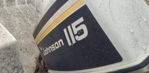

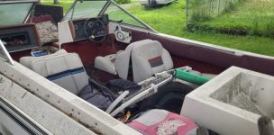

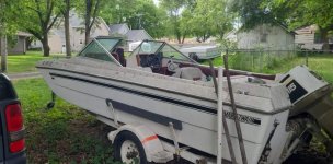

I just got a 1976 mark Twain tri-hull with trailer, that has a 115hp Johnson motor. I paid $300 for everything. But the interior is trashed due to not being taking care of and parked outside for the last 4 year.. or longer who knows.
So I am in the process of gutting it because there was a bad soft spot right in front of the gas tank. But all the other parts of the floor seem solid. After ripping the carpet off I saw the stringer is pretty much mud inside a fiberglass shell. I am going to tear the rest of the floor apart to check the other stringers and hopefully make my decision.
My question is.. is it worth it to repair this myself or junk the whole boat, keep the motor, and find a new shell/roller. I have a construction background and pretty much did everything but carpet. I will update pictures as I tear out the floor! Please help and thank you!

It takes a lot longer than you think to fix these things.----Working alone or with an assistant ?-----Start with a compression test on the 45 year old motor.---See if it runs properly.----Test the motor on the lake if boat is safe to float.------Be a shame to fix the boat to then find out motor is junk too.
Jul 8, 2021
8
I will be doing it by myself, I know that the motor was started every year for the last 4 years, but it hasn’t been in the water for 4 years.. and I don’t see and chips or cracks on the hull. I have a 5on-2off-2on-5off schedule so I will have some time to work on it. And I will hopefully test the motor this weekend and update this post! Thank you!

The boat can be whatever you make it. I've said this a dozen times. art or crap.
I have a second boat similar to this, a 79 Pisces that I gutted and its waiting for me to finish my 69 Mako.
Like Racer said, it takes a long time to do this stuff. You are Def. able to do everything, Thats a Huge plus. now do you really want to.
And at $300 the trailer is worth that.
But materials can and will snowball over and over.
You could find a better boat for sure now or later. BUT.. also.
If you build or re-build this boat, (correctly)you will have a better boat than you could buy new and it will outlast anything you buy, most likely.
My project is 2-3 yrs. but I'm not doing anything standard. and its a total down to hull build back from blank slate.. blank checkbook too.
Thats another thing to consider. most times you will not get out what you put into the build, but you could get lucky. The biggest thing is knowing what you have after it's done and that as said before is a along road. but satisfaction is a pretty good return.
The guys on this forum are always at hand to help and cheer sometimes too.
at the end of the day its a flip of the coin, build it or trash it.
many projects get started many don't get finished. many do.
Its easy to lose the head of steam after or if you start counting the money and time you spent and hurtle after hurtle.
thats my 1/2 cents worth.
Best to you.

Look at it this way - you've spent about 1/20th to 1/30th the cost of having it finished. If it's the only thing you do in your spare time, I think it can be done in under a year. If life happens, or you are splitting your spare time between boat restoration and something else, plan for 18+ months. It's worth it if you have some connection to this particular boat and/or if you love the process of restoration.
