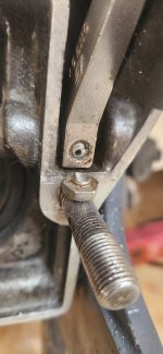

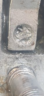

Help! I screwed up! I was putting the Bell Crank back on the boat and was tightening the bolt that holds the shift lever on the bell crank. The original OMC Shop Manual said 5-7 ft -Lbs. I was using a torque wrench. I got to 5 Ft-lbs and was going just a little more…
The bold was sheared off !!! See pictures.
I am trying to remove the bold. I have tried drilling a small hole and using an Easy Out. I was making progress and had a small hole and put in the Easy Out which then snapped off $%$#@. I should have made the hole bigger and then used a larger diameter Easy Out.
And now there is a Very hard Easy Out in the hole %$#@.
I started drilling a new hole and was making progress once again, and then … I snapped off the drill bit. The Shift Lever can move, and that caused the bit to bend and break %$#

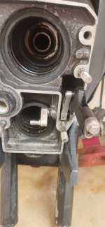

Here are the pictures. The first 2 are before I snapped off the Easy Out

The machinist got the broken bolt out, but it was not easy. I had to remove the pivot housing, then he put it on a drill press. That worked, but it all cost $450 !!!! That was an expensive lesson on overtorquing something. I was using a torque wrench. The wrench has a long handle and it was east to overtorque the bolt. Next time I will just use a 8 inch socket wrench. I will also use a low strength thread locker to prevent the bolt from backing out
I also learned a lesson about Easy-Outs. They are brittle. I should have gradually opened up the hole and used a larger Easy-Out. That may not have snapped.
Another lesson would be to confirm the hourly rate before working with a machinist. It would have been cheaper to just cut through the bell crank and replace both the crank and lever!!
I was able to save the shift lever by drilling out the hole a little larger and tapping in new threads. I went up tp 5/16 - 18. I will use a stainless steel socket head cap screw and the thread locker I mentioned above.
