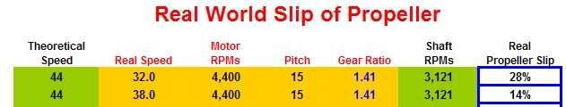

Joe, you may be right on the weight, because if I use 5,500 pounds and a 1.41:1 gear ratio I come up with the 15" prop pitch you are using now,but I show you ought to be able to do about 38 MPH with 1 person on board. Please verify the gear ratio.
I am showing your prop slip to be 28% right now and that is high, if we can get it down to 14% you will be doing 38 MPH at 4,400 RPM.
