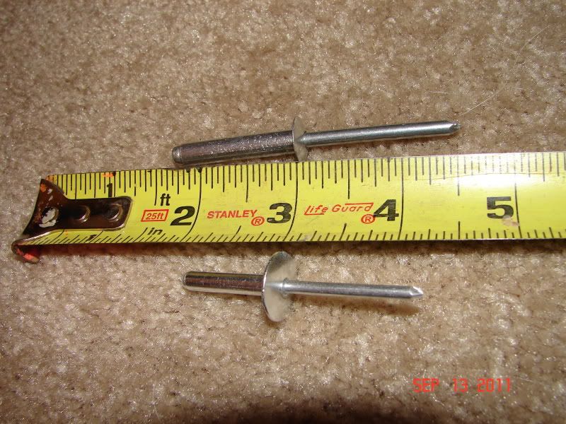

Shoot yeah!... but you can't use the little ol' wimpy ones, ya gotta use the big ol' gnarly ones like these.
I'd say a minimum of 3/16" diameter Large Flange (head) or a 1/4" dia. dome head, be sure to get the proper grip range for the thickness of your plywood or they won't hold worth a dang.
I'll be using these rivets to fasten the decking down in my boat in a few days.
You'll probably need a heavy duty rivet tool like the one in this vid for the 1/4" dia.
http://www.youtube.com/watch?v=L0MA1-5NXjs&feature=related
