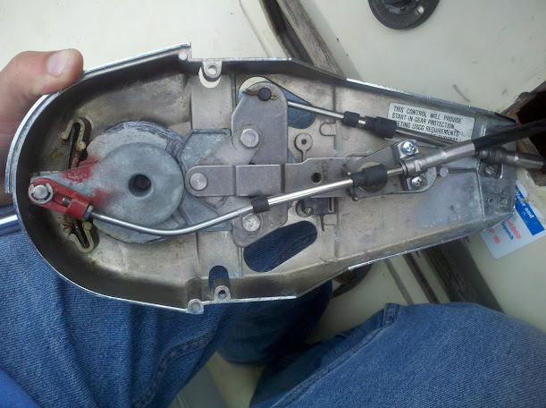

Speaking of controls, I thought I had them hooked up correctly but I noticed that the controls got stiff. I opened up the control box to check and I found the new throttle control cable end bent to my dismay, so looks like that cable is ruined and there goes another $40. I was trying to figure out how this happened and the only thing that I can think of is the control cable fitting weren't threaded on the control cable correctly. Although, I noticed that the control arm doesn't appear to be fully flush against the swivel bracket because part of the cable end overhangs the bracket (it has no where to go because this is where grove is for the clamp). So I might have to grid this swivel bracket back a little to accommodate the cable (which I find odd).

Re: Help with 1990 90hp Force controls
Youcan bend that straight.
You have the connectors on the right cable?
I think the short one is the shifter?
I'll look and get back.
Yup short one on the shifter.

Jerry,
The connectors are on the right cables (longer one on the throttle, shorter on shift) and the cables are hooked up properly on both the engine and control box ends. But I may have to fine tune the adjustment on the connectors on either end. Any thoughts on how I can bend the cable back?

UPDATE: So my local WM was nice enough to exchange the bent cable for me (they know me too well) and I was successfully able to re-install the throttle control cable. It took some time to get the throttle and shifter controls synched up properly, but I got it worked out in the end. I realized that after servicing my lower unit that I had to get the shift rod back in synch with the lower unit gears by spinning the prop rod and prop. Also, it seems that my the tach is not working properly...it says that I am idling at 2000 rpm's when it clearly is not. My tach is the one used with the mercury controls that I replaced.....so was wondering if there is a way to adjust the tach or do I have to change the Tach from Mercury brand to US Marine or ...?
