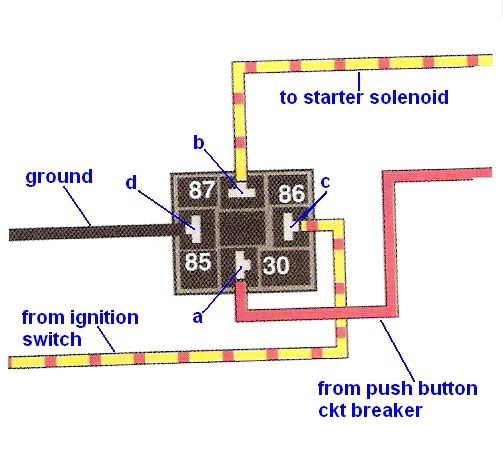

Now, locate the slave solenoid or relay, on the engine. Notice the 4 wires to it?
or for those with a Volvo that have a relay instead of a solenoid use this picture.
Hook up your test light again with the clip on a good ground. Now touch terminal C of the slave solenoid with your test light and have your helper turn the key to the start position again. The light should light up? If it did, touch your test light on terminal A, if it lights, hook your test light lead to it, and put the probe on terminal D (the ground) if it doesn't light, then you have a bad ground for the slave solenoid and without that ground the slave solenoid will not work.
If the test light did not light up, then the problem is 1 of 3 things either the connection at the main engine harness plug is bad, or you have a bad neutral safety switch or a bad connection between the ignition switch and the slave solenoid.
If you are at home, this isn't a problem and you can track the problem down. But if you are out on the water what can you do? Simple. Use a test lead on the slave solenoid to jump between terminals A and B or A and C and the engine will crank. Make sure the ignition switch is in the run position and the engine will start.
Ok, lets say when you hit the switch you hear a click from the engine, but no cranking of the starter. Now what do you check.
Simple, back to the slave solenoid on the engine. Hook up your test light clip to a good ground and touch the tip to terminal A, if it lights, touch it to terminal B and have your helper hit the starter switch again. If you hear a click and the light does not come on, then the problem is a bad slave solenoid. If you are out and need to start the engine, you can disconnect the wires from terminals B and C and hook them together and you will be able to bypass the slave solenoid all together and it should work. If not, due to long wire runs, just jump between terminals A and B to crank the engine over.
