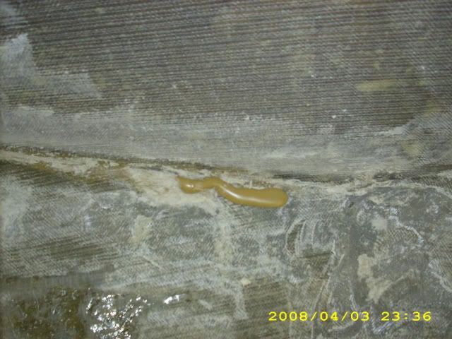

the problem with using PL construction glue to attach a transom....is that the carp takes a few days to cure!
this is what happens to pl if you glass it and dont let it cure for a few days
if you spread thickened resin on the skin....then glass it.....then attach the wet glassed transom to the hull and clamp her down......
you can immediately move on to filling the gap with pb and tabbing the new transom on....
by the time you are finished filling and tabbing......you can pull your clamps and do your 1.5 csm and 1708 full wrap and walk away and drink beer before the pl has even set !
everything wet on wet.....chemical bonding......it does not get better than that !
