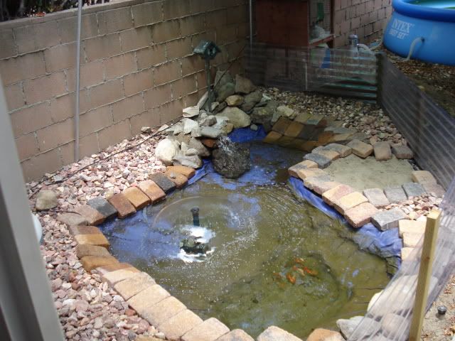

i have built three ponds none with large waterfalls though. it is pretty easy just make sure to level everything. a pond looks really bad if one side is overflowing and the other side has a foot of liner showing. buy the biggest pump practical they are close to trolling motors in the sense that you can always regulate/turn down the gph. with your size pond and height of waterfall i would build up the waterfall area with cinder blocks or similar and finish it by fixating rocks ect to your "base" of cinder blocks
hers a pic of my pond
Why the fence, cats or kids

Re: Help with waterfall
it was to keep the turtles in
