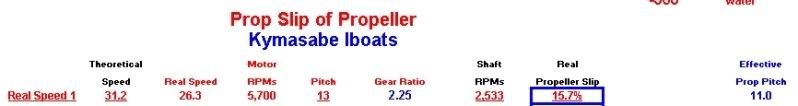

OK, got the boat back from the shop today, got the WOT problem fixed, had a trigger problem, trigger replaced and now running 100%.
Latest sea trial says: running at 26.3 mph at 5700 rpm's, 5 gallons fuel on board, no passengers, just 270 lbs of me, trolling motor, two batteries, rod/reel and small tackle box.
I'd still like to squeeze a little more speed out of it if I could, do you think going to a 4-blade prop would be better or stick to the aluminum 10&1/8thx13 3-blade Turning Point Rascal that's on it now?
Reminder: 1995 Starcraft Seafarer 14 DLX aluminum boat, side console, 14.5 feet, aprox 450 lbs.
1995 Mercury 25hp 2-stoke outboard. 2.25x1 gear ratio.
Please let me know what the equation says would be my best choice of a prop and pitch.

kymasabe, we are doing better than we were, so now before we make any more decisions let's get as much as we can out of this prop.
Right now we have a prop slip of right at 16%, and that is borderline in my opinion, so let's raise the motor up 1" higher and see if we can"t get a little more speed and lower our prop slip some more.
Prop Slip
I also need to know is this going to be your NORMAL load you carry on the boat or not.
H
