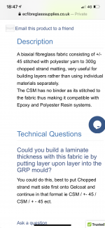

Hi I think the combi mat supplied in the uk is compatible with epoxy , also how do I get to the links you have supplied
