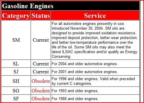

The truth is they change the formulations all the time. Even the link Don S posted shows the Volvo Penta oil as API SG:
Which has been superceded by newer standards:
