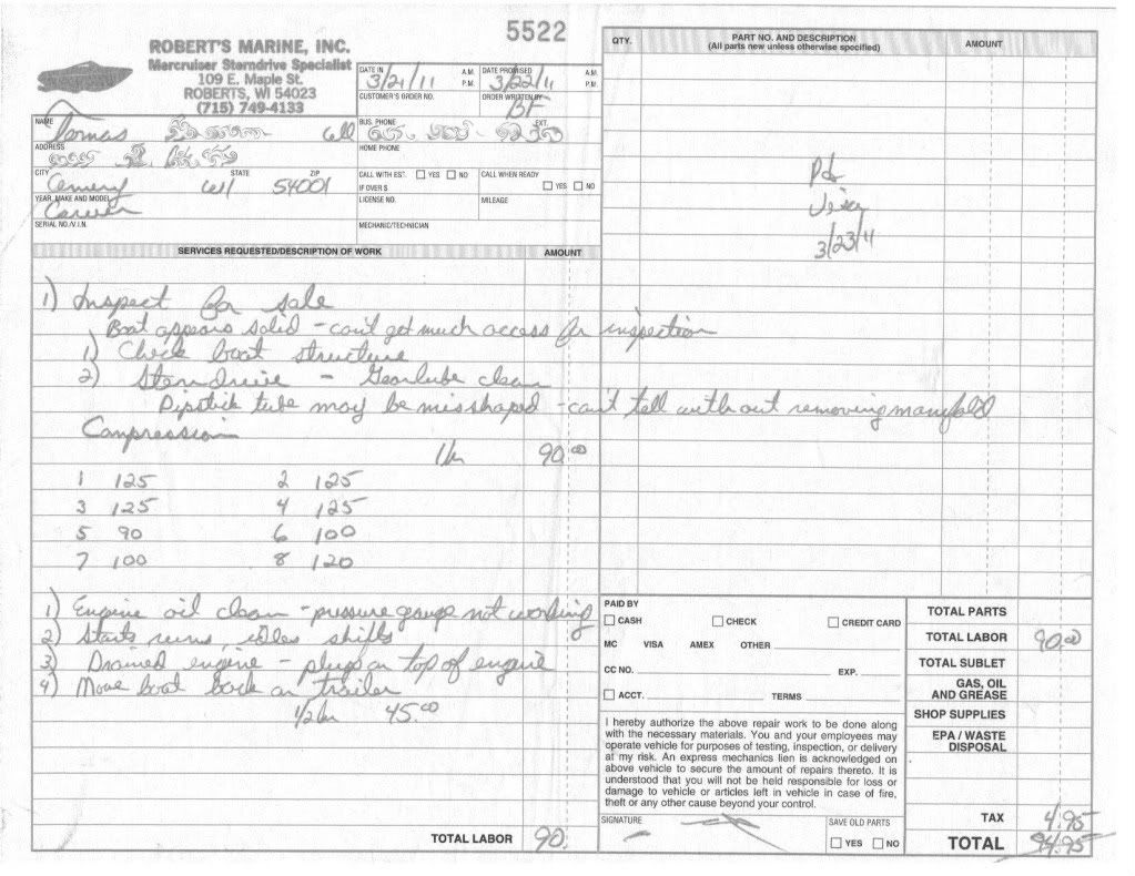

Some problems I have with that though. First of all ever since I as 16 I have done all the maintenance on every vehicle I've ever owned. A couple of times I have paid for work to get done I was screwed pretty badly due to improper diagnoses as well as service writers who just want to sell the most expensive job possible. The last one was with my company car that's paid for by our tax dollars, and therefore I've been a bit jaded about this recently. I know that most mechanics are good ones, but how will I know a good one from a bad one? I even had one shop that proclaim themselves to be MerCruiser Experts tell me that THESE compression numbers on a boat I was thinking about buying were acceptable!
Yeah. and according to that invoice, they should have charged you 1.5hr labor but only charged 1 hr!
