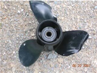

yours is repairable. This one...

By jimmbo, good thing for the owner that this baby was alum. Grin.

Now that one has some serious issues !!!!!
