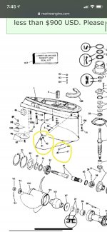

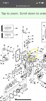

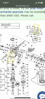

Here are some photos of the parts diagram showing the fill plugs.
Plug 47 and 41
Plug 2 and 16
Plug 83.

Lower unit, upper unit and the intermediate housing are all separate gear cases. They all take regular 90wt gearcase lube (nothing special), but they each fill independently. Lower unit will have a fill hole on the bottom, and a breather hole up above. Upper unit has a fill hole on the side, and the breather is on the very top. The intermediate is a single hole access.
