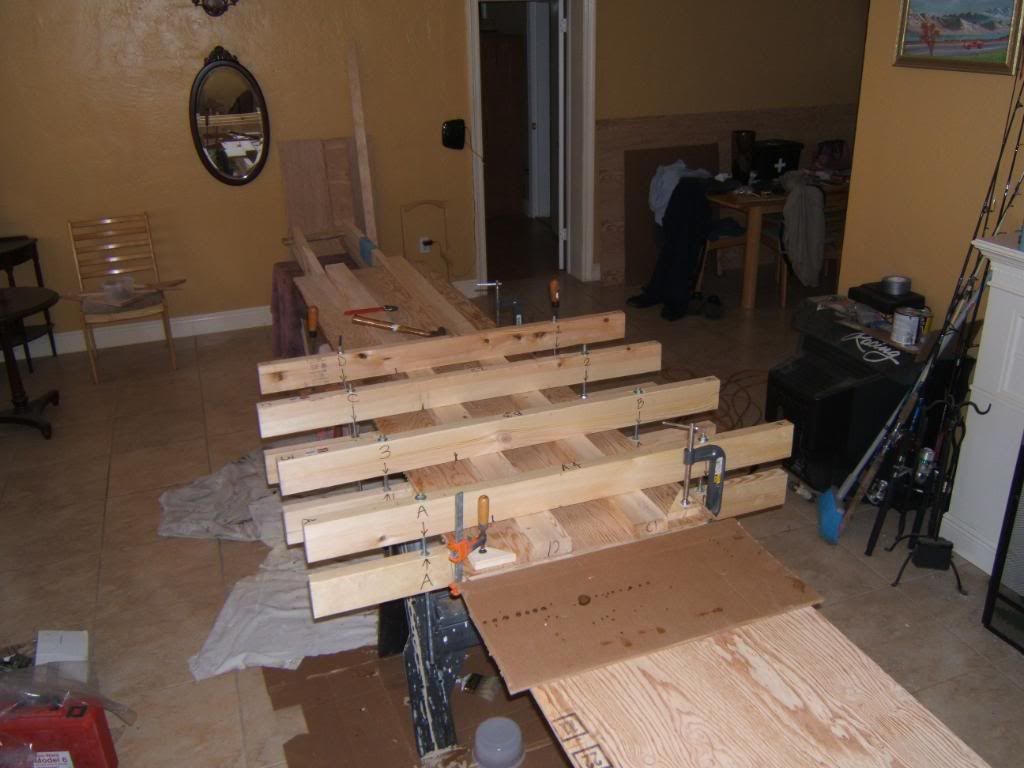

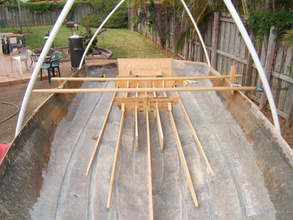

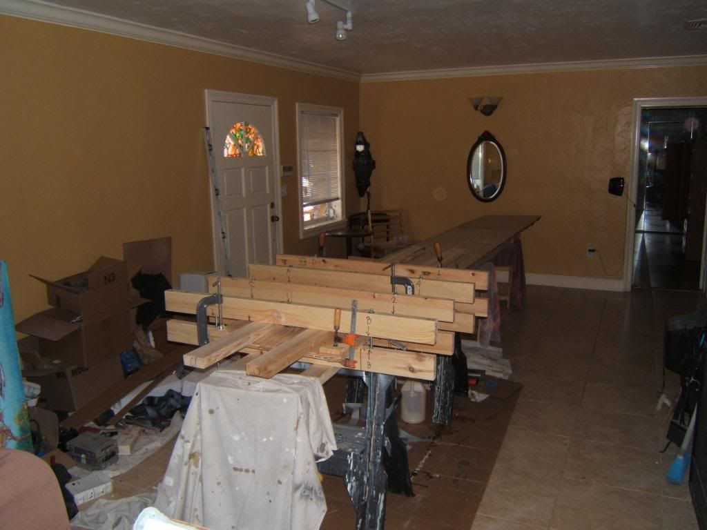

I will let the more knowledgeable guys fill you in on whether or not you can use spruce, but I made a laminated blank for my stringers out of two sheets of 3/8 inch AC fir ply...it ended up 16 feet long, 2 foot wide, by 3/4 inch thick...
Here's a couple of pics to give you an idea...
And a pic of the stringers I made out of the blank...
Have fun and Best of Luck!
