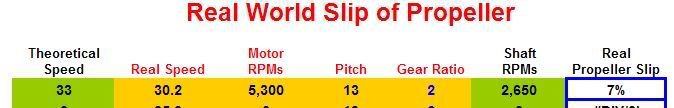

I currently have a 1990 Sea Pro 18ft CC with a 1975 Johnson 115 motor. The average weight of the boat loaded is around 2350 lbs and the motor has a 2:1 ratio. The boat has a stepped transom and I am in the process of making a jack plate for it now, hopefully I will be able to get some time in the machine shop over the 4th holiday. I have the motor raised as high as it will go and believe that I still need to go up some, but I would like to get a baseline of where I am at now.
I took it out today in slightly choppy water, but not bad and got a WOT of 5300 rpm and a top gps speed of 30.2mph. I currently have the tilt and trim off, but I did put a level on the bottom keel of the boat and the AV plate and leveled both. I am running a 13.25 X 13 Solas aluminum 4 bladed prop. Can you tell me where I am at now? I realise that I am loosing some from the shape of the lower unit, but I want to get the most out of this set up. Thanks Carl

Crb, your prop slip is at 7% right now, and that is about as good as it gets.

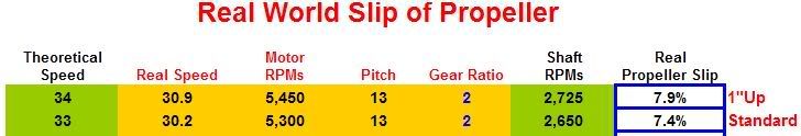

Can you run it one more time for me? I finished the jack plate and raised the motor about an inch, the boat again is a 1990 Sea-Pro 18 foot CC, 17'5" in actually. Hull weight with out motor reported to be 1500lbs with motor fuel gear and passangers around 2350 to 2500 lbs. I am running a 1975 Johnson 115 with a 2:1 gear ratio and I am running a 13.25 x 13 pitch solas 4 bladed prop. In simular conditons today light chop, but not bad I got to 30.9 mph gps and 5400 not quite 5500 rpm but all most. This was after raising the motor and tweeking the timing. I know I will be close to what I was before but I am curious as to what improvement I may have gotten. I truly believe that I have this 1975 motor maxed out on this boat so I may be a little underpowered for where I would ultimately like to get (35-38 mph running 56-5800rpm). I expect that I just went to a lot of trouble for very little gain, but I guess that is the fun part seeing what you can get out of one. Thanks for the help! Carl

Carl, you gained some RPM and some speed but your prop slip rose by .5% to 7.9%. When you get down to trying to get every last little bit of MPH out of your setup and you have the ability to raise the motor as much as you can you might look into a semi cleaver or something along those lines, that 4 blade is designed for pushing heavy loads and is not that great a design for surface running. But if you run the boat in rough seas on a regular basis it definitely holds the boat better and stops you from having to be a throttle jockey all the time. You might try raising it some more though and see if you can get more RPM without it ventilating. I will tell you in the same exact same make and model of prop you can easily find a difference of 1 to 2 MPH at the speeds you are running right now just because of differences in casting and the hand finishing quality that was done on the prop. Many, in fact most props, have a lot of the finishing done by hand at the factory after they are cast, and some are finished better than others in the same finishing processing.
