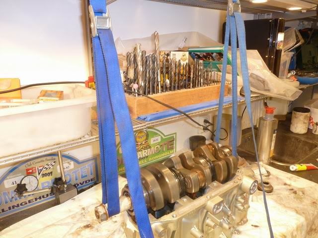

I did hang the crank assy in two straps so I could lower it bit by bit, it did work well!

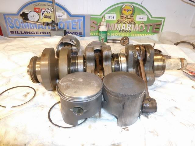

Regarding the second piston (that maby should have been replaced), I got the recomendation (from an two-stroke racing guy) that a replacement wasn't needed.
The scoring was barely seen, couldn't have been more then 0,02-0,05mm, so I grinded the piston very carfully so the outer surface went smooth.

New/old piston:
Crank hanging in straps:
