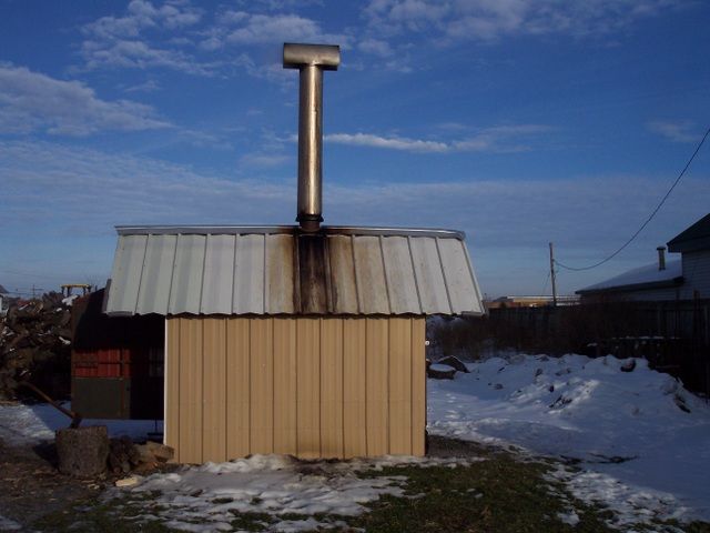

Ayuh,.... Seein's this thread is 'bout Efficiency, I gave up Efficiency of heat, for Efficiency of Dollars,...
Back when oil was 1/2 the price of today, my oil boiler/ baseboard hydronic heat ran 'bout 4 Grand a year, oil truck every 2 weeks,...
A 100 year plus ole farm house, with 1/2 dozen additions, 'n no plannin',...
Heat loss, tell me 'bout it,...
So, I decided to build me an outdoor wood boiler,...
Here's a few pictures of the project,...
'bout every piece but the controls were Right out of a Dumpster,....
even a few of the controls are dumpster goodies,...
Since I've hooked up with a local Tree Service, my wood supply is virtually free,...
Barter is such a lovely thing, ain't it,... ;)
GA_Boater
Honorary Moderator Emeritus
May 24, 2011
49,038
Re: I need new high efficiency furnace
I guess Bondo had a helping hand building the warmest outhouse on the planet. :D I've seen references in the forums to your heating plant, but the first time seeing it. That is a masterpiece. How often do you have to load her up?
