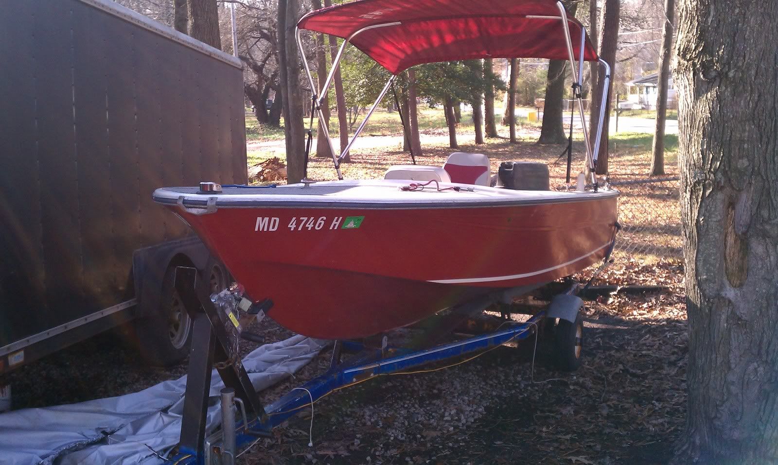

Ok, this year at the beginning of the crabbing season, I got a heck of a good deal on an old 64 Glasspar that had a rebuilt transom and new interior layout with a new floor, new paint. I literally felt like I was stealing this boat since I only paid $400 for it with title, trailer with title, fish finder, and a 1956 seaking 12hp motor. The boat was converted to tiller steer and used for crabbing. Since we bought it, I have upgraded to a 1973 johnson 25 hp tiller, but I am way to big to be in the back of the boat, and it is a pain to get it on plane with me and the wife, plus our gear. I have to lean as far forward as possible and almost bounce to help the bow drop and get on plane.
I am looking to install remote steering on my boat, but dont know where to start. I am either going to convert my 25 to remote steer, or I am looking at buying a 62 evinrude 40hp, with controls. I would prefer teleflex steer, but dont know which style to get(rotary, or rack and pinion) I do know I will need an ezy-glide universal motor bracket, the cable, steering wheel, and helm. I have also thought about going the original route and running a cable and pulley system. I have some of the pulleys in place already along the sides. But finding a vintage steering wheel with a cable/pulley helm is a PITA!!! which would be the best route to go.
Thanks in advance Mike
A little eye candy
This is the way we bought it
and how she looks now

That looks like a Citation- I've got a '60, which has the same hull- They are nice riding hulls!! 25 HP is probably on the low side, though- It's going to be tough to get much out of her when you're loaded down. The 40 HP will do fine- Mine HAD a 50 HP on it. I've got a 85 on it now.
It looks like your transom was cut down to fit a short shaft outboard- From the factory, that boat would have taken a long shaft, but it appears to have been lowered. This will severely limit your choices in repowering.

Well from research, I found that 64 glasspar 12' were only rated to 35 or 45 hp(i cant remember which), I wish it was still a long shaft transom, but the 40 I found is the old standard transom(17") and I have a stainless bracket that lifts the motor 2" so it fits perfectly. I am not sure if the old 40hp I am going to look at has a steerinf tube or not, I will take pictures tonight if I buy it.
