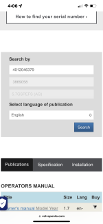

Justchillin4
Recruit
Jun 22, 2022
4
Pic of distributor in question
alldodge
Mar 8, 2009
43,034
Thanks for the S/N shows GSPEFS
May just be point and shoot. Usually about 8 BTDC
Your right, point and shoot, and should be 8* but I don't a VP manual which states that, only Merc manuals stating the same
